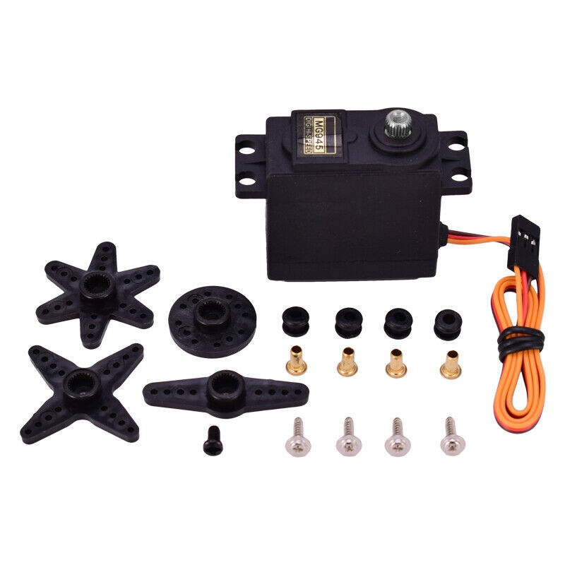

MG945 Towerpro Digital Metal Servo 12KG High torque
MG945 is for 1/8 buggy monster and many RC model.
It is low cost of digital servo with export quality and great servo for just about any application.
Weight: 55g
Dimension: 40.7×19.7×42.9mm
Stall torque: 10kg/cm (4.8v); 12kg/cm (6v)
Operating speed: 0.23sec/60degree (4.8v); 0.2sec/60degree (6.0v)
Operating voltage: 4.8 ~ 6.6v
Temperature range: 0- 55deg
Gear Type: Metal gear
Dead band width: 1us
Power Supply: Through External Adapter
servo wire length: 32cm
Servo Plug: JR (Fits JR and Futaba)
servo arms &screws included and fit with Futaba servo arm
It’s universal “S” type connector that fits most receivers, including Futaba, JR, Hitec ,GWS, Cirrus, Blue Bird, Blue Arrow, Corona, Berg, Spektrum.
CE &RoHS approved
We have upgraded our servo gear set and shaft to aluminum 6061-T6.
It is stronger and lighter than copper.
