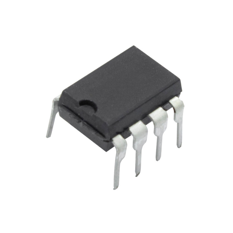

تراشه آپ امپ OP07 پکیج DIP
کد کالا: 2101008002
آی سی آپ امپ تقویت کننده OP07 پکیج DIP
100 2% 37,828‎ تومان
500 3% 37,442‎ تومان
386,000 ریال
Manufacturer: Texas Instruments
Product Category: Precision Amplifiers
RoHS: Details
Series: OP07C
Number of Channels: 1 Channel
GBP - Gain Bandwidth Product: 600 kHz
SR - Slew Rate: 0.3 V/us
CMRR - Common Mode Rejection Ratio: 100 dB to 120 dB
Ib - Input Bias Current: 7 nA
Vos - Input Offset Voltage: 0.25 mV
en - Input Voltage Noise Density: 10.5 nV/sqrt Hz
Supply Voltage - Max: 36 V
Supply Voltage - Min: 6 V
Operating Supply Current: 2.4 mA
Maximum Operating Temperature: + 70 C
Shutdown: No Shutdown
Mounting Style: Through Hole
Package / Case: PDIP-8
Packaging: Tube
Amplifier Type: Low Offset Amplifier
Height: 4.57 mm
Length: 9.81 mm
Product: Precision Amplifiers
Supply Type: Single, Dual
Technology: Bipolar
Width: 6.35 mm
Brand: Texas Instruments
Dual Supply Voltage: +/- 5 V, +/- 9 V, +/- 12 V, +/- 15 V
In - Input Noise Current Density: 0.35 pA/sqrt Hz
Maximum Dual Supply Voltage: +/- 18 V
Minimum Dual Supply Voltage: +/- 3 V
Operating Supply Voltage: 6 V to 36 V, +/- 3 V to +/- 18 V
