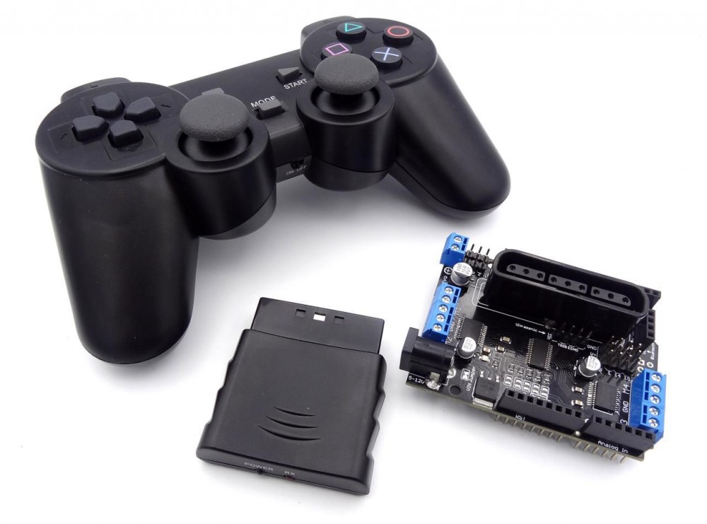

شیلد آردوینو TB723 به همراه درایور موتور سروو  با قابلیت اتصال ماژول بلوتوث HC-05 و اولتراسونیک SR04
شیلد آردوینو TB723 به همراه درایور موتور سروو، با قابلیت اتصال ماژول بلوتوث HC-05 و اولتراسونیک SR04 می باشد. قابلیت های این برد باعث می شود تا بتوانید کنترل ربات خود را از راه دور بدست بگیرد. همچنین شیلد آردوینو TB723 قابلیت اتصال ماژول های مختلف را داشته و نیاز به مدارات جانبی را تا حد زیادی کاهش می دهد.
Arduino Motor Servo Shield Driver Board PS2 Handle Wireless Remote Control mearm using PCA9685 and TB723 chip combination, very stable and highly scalable, Arduino control board and driver board through the IIC communication, so do not take data pins, can give players greater scalability. The driver board can not be used alone, need to cooperate with Arduino uno development board Designed specifically for the PS2 handle slot, easy to achieve wireless remote control Full support for graphical programming
Product Features:
1, to provide dedicated PS2 wireless controller interface, and can be completely plugged into the arduino uno development board
2, through I2C and arduino communication, can be cascaded cascade
3, can be accessed by six steering gear, two of which are directly controlled by Arduino, the other four driven by the PWM driver.
4, can be connected to four DC brush motor or two 4-wire stepper motor.
5, the use of TB723 motor driver chip, 1.2A drive capability, peak 3.2A, spike L298N module
6, with complete sample tutorial and code base.
7, support for ultrasonic sensor interface and Bluetooth module interface.
